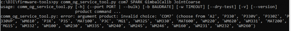

After installing python and pyserial I tried to start the process by command
py comm_og_service_tool.py com7 SPARK GimbalCalib JointCoarse
but I get this message:
The Spark is switched on and the USB cable is connected. Also the COM port ist wright (COM7 in my case).
I ran the cmd prompt via admin.
Python 3.10
Can anybody tell me what's my problem?
Thanks and kind regards from Germany!

Hey,
I had tha same problem.
For me it was a simple but effective solution:
just add --port befor the actual port so in you case:
py comm_og_service_tool.py --port com7 SPARK GimbalCalib JointCoarse
I did that with my Mavic Air 2 and it worked perfectly.
